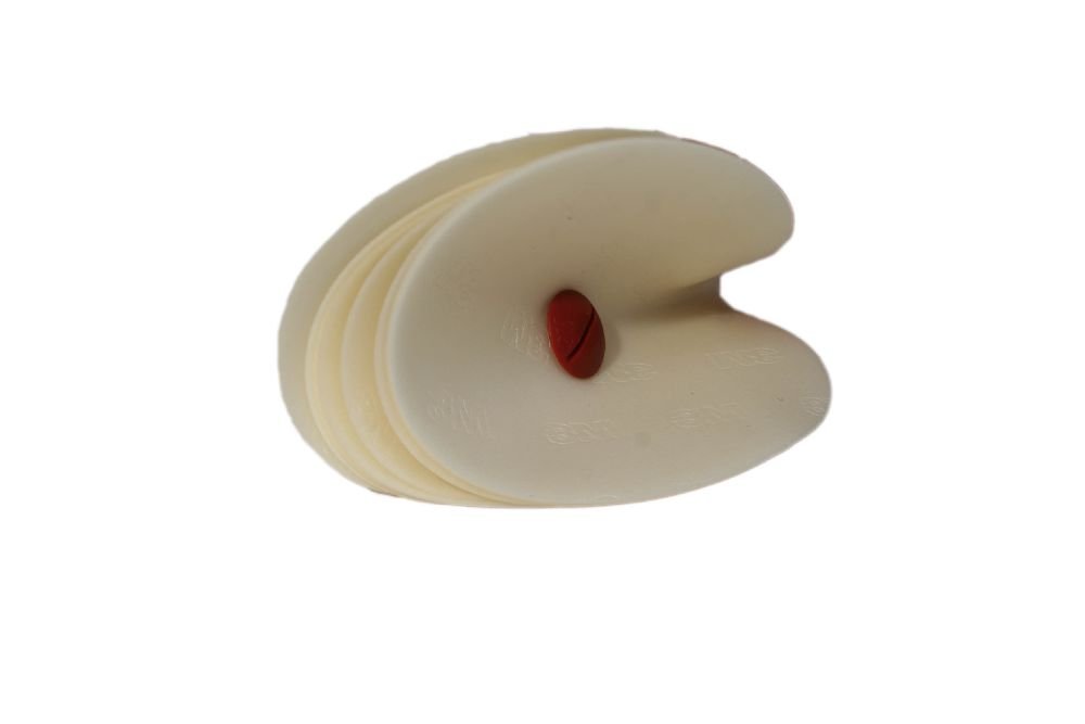

Didn't do it yet. My boat is a 2006 so I don't expect it to come off in one piece in one pull. I have one of those 3M wheels for removing tape stripe. It works well but it's basically an eraser and it will take a lot of time.
http://ecx.images-amazon.com/images/I/41yTpzD1hhL._SX342_.jpg
I have two stripes down each side. Almost 150 linear feet. I can try some heat as well. Open to any suggestions on that.
I tried everything and the wheel worked the best. In fact, nothing else compared. I used a heavy duty right angle drill and the wheel eraser.
The one I used was different, it looked like this

How does that wheel spin if it's not round? Looks like it would be all over the place.
I used the drill mounted eraser on 40' of stripe at the water line. X 2. Stripe was about 3" wide. It wore my hands and wrists out but it all came off, glue, stripe everything.

With centrifical force, the wheel is round and has many layers.
